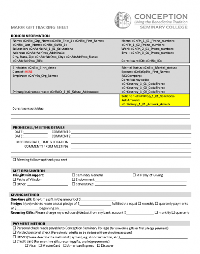

Here is an example of our letter merge:

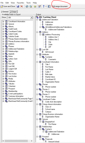

And here is an example of the Word doc we merge into:
