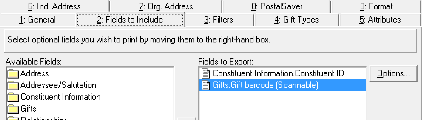

    Hi,
    Sorry - my response about barcoding being within appeal cards needed some additional information. It isn't that obvious, but you can find it under "fields to include":
    When you have Gifts.Gift barcode highlighted, you need to click Options and select a Fund. And under the Format tab, click Output Options and that is where you specify the appeal and package. So you'll need an input query for each package.
    Did your direct mail vendor generate the QR codes? You might need to do some research in Blackbaud's knowledgebase about the specific format needed so that you can inform your vendor.
    Karen
