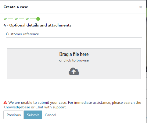

Tried to open case with support. Interesting - last screen say "We are unable to submit your case. For immediate assistance, please search the Knowledgebase or Chat with support."
