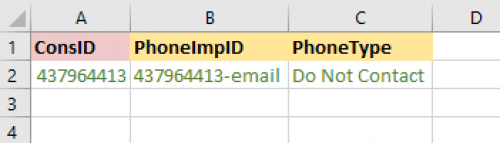

Yes, you could, as one option, change the Phone Type on the email addresses. You'll need two other pieces of data; the Constituent Id and the Phone Import Id. Export those two values for each email address you'd like to update and add a third column called PhoneType (screenshot below). Then use a Constituent Phone Update Import to update the Phone Types in Raiser's Edge.
One advantage of this method is that you can filter by PhoneType in your exports to exclude your Do Not Contact addresses.

Correct. All of your phones and emails have an Import Id and it's the Constituent Id and the Phone Import Id you'll need to change the Phone Type using Raiser's Edge Import.1
