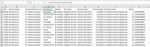

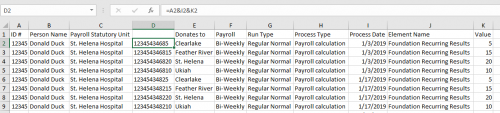

I have a solution!
So, you'll need to concatenate donor Id with gift date and gift amount in both spreadsheets, and then VLOOKUP on that key you just created. This solution assumes that no one donor will give more than one donation with the same dollar amount on the same date. If that happens the solution breaks down (unless the donor always gives to the same designation, in which case my solution is clunky, but it should work).
Spreadsheet with known designations (pay attention to the formula)
Spreadsheet without designations

You'll need to add two columns to the report
The first new column is Gift Count. The formula is:
=IF(ROW()=2,1,IF(A2=A1,D2+1, 1))
I put this is column D. If you put it in another column, then just change the D1 to match the column it's in. And then A2=A1, that's just looking for the Person's ID.
The second new column is Unique ID. I put this in column E. This is creating a unique ID based on the Person's ID the Process Date and the Gift Count. The formula is:
=$A2&"-"&$J2&"-"&$D2
Then you'll use an Index/Match formula to connect the two sheets. Formula:
=IFERROR(INDEX(Location!F:F,MATCH($D2, Location!D:D, 0)),"-")
Change the word "Location" to whatever you call your tab (or name your tab Location). The F in the formula is assuming the "Donates to" field is in column F on the previous page. Where you see D (D2 and D:D) is looking for the Unique ID in column D, but you can adjust this as needed).

Let me know if you need more info or have questions about modifying or working with these formulas (so it doesn't take a long time to get each new report run set up). I have reattached your spreadsheets with my formulas in there. You'll see I created a Mickey Mouse person just to make sure it would work with multiple people.
