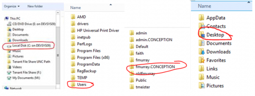

If BB is hosting you, then you must route the files to your own desktop by clicking "save as" and routing through your C drive onto your PC account and desktop. At our office, it looks something like this:

C: Drive on your Citrix/Blackbaud server is likely a restricted folder. You should maybe ask your IT people to create a dedicated network folder where exports, etc can be saved. These can be group-specific in case of sensitive data, reports, imports, etc.
