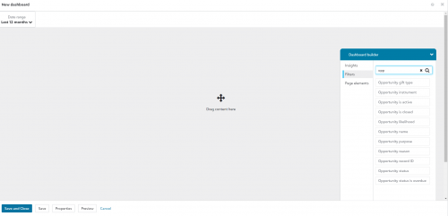

If you go to Analysis - Report Builder - new dashboard and search for "opp" you get this:

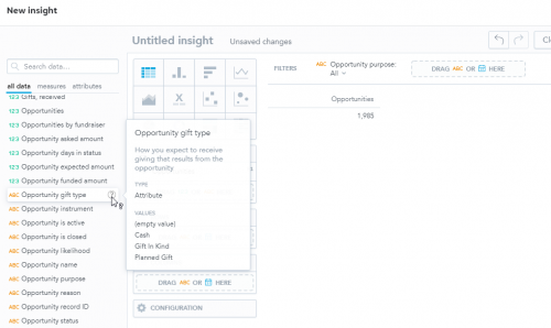

Soo maybe you can't filter an entire report by the Opportunity Gift Type, but it looks like you can use the "Opportunity Gift Type" field as a filter in a custom Insight which you could then include on a custom dashboard. We don't actually use it here, but it should work just like any other filter. Here's a quick screenshot from the Insight Designer:
