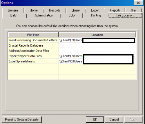

    The one thing I can suggest to check is in RE under Tools -> User Options... -> File Locations.  Be sure there is a file path entered for every option you use.

    Now, going to the File Extension tab as you suggested, all I'm seeing is a path for is the AddressAccelerator Data Files.  To be clear, I want to save the .docx files in a folder of my creation and the .mdb files to disappear or save somewhere else.  I just looked at my colleague's tab, and his looks the same as mine, but he also never sees .mdb files.
  • Are you sure AddressAccelerator is the only option you have available to set a file location? You should see something like this:

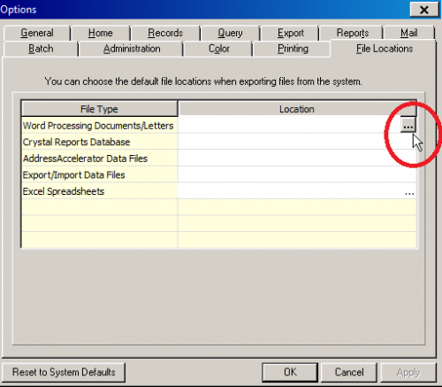

  • I do see that window.  I meant that AddressAccelerator Data Files was the only line that had a location indicated.  All the rest are blank.  This is also true for my colleague who doesn't get visible .mdb files.
  • To your point, not setting the file location may not be the problem, but that's what John was suggesting you set. If you click in the white space next to any file type, you'll see an ellipsis appear. Click on that ellipsis and browse to your desired location to set that location.
    1c87bf5c5c596c916ecfb7c049aa9622-huge-op
  • Yes, I understand how it works.  My point is that my colleague also does NOT have any file locations selected there except for AddressAccelerator, yet he does NOT see the .mdb files.  This leads me to conclude that this window may not be the solution.  A question I do have about it, though, is if I select a location, will it save the .docx files there as well?  I currently have those saving to my desktop.
