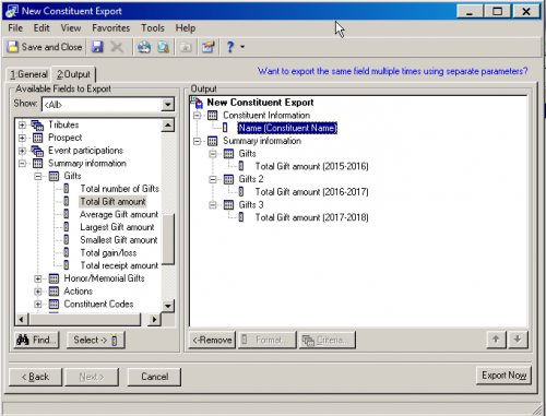

    I would plug a Constituent query into a Constituent Export. Below are screenshots of what I would use for the criteria in my Constituent query and the Results for my Constituent Export. The criteria you see will present results for only the constituents that made a gift in all three fiscal years.

    573397b08407838429518ac4a6e5a78f-huge-qu
    79c07dd6fb3aea4731192a84e0d644e7-huge-ex

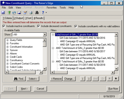

    Here's what the query looks like if I finish building out the Gift Types and specify the Annual Campaign.
    8832e3c5e161e9f9bf948b53a2129f8b-huge-qu

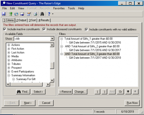

  • Attached is a screenshot of my query criteria.
  • You need to have AND between the summary totals, you have OR.
  • The other problem is that you are using less than or equal to $999. Guess what number is also less than or equal to 999? Zero! You're retrieving every constituent in your database with that query.
    Change the ORs to ANDs and change the gift amount to BETWEEN $1 and $999.
    EDIT: I see you are also including Recurring Gift in your Gift Types and that's a pledge. You should only include Recurring Gift Pay-Cash, the pledge payments.
