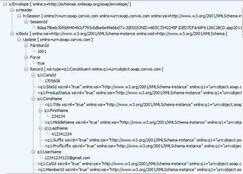

Looks like the problem lies in the way service reference Update method is building SOAP request envelope.
public Luminate_Tools.LuminateWS.RecordModificationResult[] Update(Luminate_Tools.LuminateWS.Session Session, string PartitionId, System.Nullable<bool> Force, Luminate_Tools.LuminateWS.Record[] Record) {
Luminate_Tools.LuminateWS.UpdateRequest inValue = new Luminate_Tools.LuminateWS.UpdateRequest();
inValue.Session = Session;
inValue.PartitionId = PartitionId;
inValue.Force = Force;
inValue.Record = Record;
Luminate_Tools.LuminateWS.UpdateResponse retVal = ((Luminate_Tools.LuminateWS.Soap)(this)).Update(inValue);
return retVal.Result;
Update method requires Constituent record as an argument, but then it includes ALL record fields in the request, including fields that are read-only and need to be null, otherwise Update returns an error "Attempt to update read-only field". Meanwhile apparently there is an unspoken rule that if the request contains more than 10 null fields, all null fields are being ignored.
There are more than 10 read-only fields in the Constituent record, which leads to a situation, where Update method cannot be used to blank out the value of the field, because null values are always ignored.0
