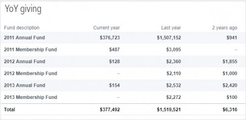

3.) If you are looking for a single report with columns for each year, there is currently not a default insight that shows this view. It is possible to build this if you have the optional Insight Designer under Analysis > Report Builder > Insights tab > + icon. You can add a measure multiple times and filter each specific measure to a time period in the measure itself. So you can add Gift received amount filtered to the current year, filtered to last year, and filtered to 2 years ago to have three amount columns like the below example.
