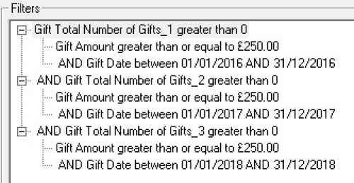

  • You could use the summary information, which is found near the bottom of the list in a constituent query. You'll need to add a new summary for each of the three years, with a criteria of total number of gifts > 0 and filters to only include gifts with a gift amount >=$250 and gift dates within 2016/2017/2018 (plus any additional criteria you might need to include only the relevant gift types/funds etc.)

    But doesn't the Summary Information give the cumulative gifts for each year?  They're looking for single gifts of $250up in each of three years.  Am I interpreting my results incorrectly?

  • If you set up a query with the below criteria, you should end up with constituents who have given at least one gift of $250+ in 2016, and at least one gift of $250+ in 2017, and at least one gift of $250+ in 2018:
    6d05cc81099df3e82877714303f68b94-huge-re
    Because of the filters within the summary (the indented bits), only gifts more than $250 are being counted towards the total.
  • Shani,  Thanks for your response.  Tried this, but come up with Zero because it seems to interpret my criteria as one gift with all three years as its Gift Date.
  • Alan,
    I am
    suspecting that you are a QUERY GOD!
    J  This is
    definitely a different progression that I have been beating my head
    against for the past three days.  Excited to try this.
    Will let you know if you have saved my life!
    Kera
  • You're welcome, hope it works for you. I picked up most of my query knowledge from these forums so it's nice to be able to pay it back occasionally laugh
  • Thank you ALL for your suggestions and comments!  This is the first time I have used the Community Discussions and I am a sincerely believer now.  The query is completed and reported, and I feel like someone just shot a 4 ton buffalo off my back!  Be well, all.  Youse is da best-est!
