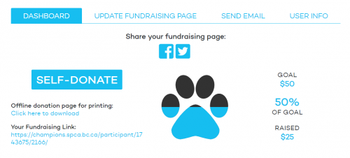

The BC SPCA had the same idea- makes sense to put it in their participant centre if needed and encourage online donations as much as possible! I ended up building their DIY fundraising site (champions.spca.bc.ca) using WordPress as a CMS and with custom JS/PHP for all the standard TeamRaiser functions that need to connect to Luminate. This makes adding in features like an offline donation form in the PC a breeze, since you can just make edits in WordPress to the PC template as needed!1
