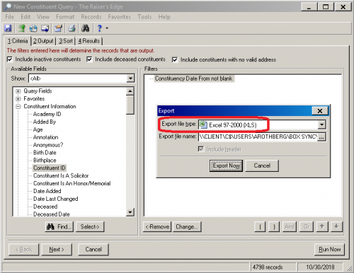

It makes sense that exporting to CSV would strip your cells of any formatting so that's why the dates are not showing up as dates. Your suggestion to import the data into Excel was going to be my first suggestion. Seeing as you mention specifically you want to know how to solve this exporting from a Query, I find that when I click the export button in Query, I can change my Export file type to Excel 97-2000 (XLS) which does preserve the date formatting when you open the XLS. If you have a reason for exporting specifically to CSV this solution of course won't work.
I was unable to export to Excel formats beginning in the summer of 2017 with a Windows update, and had not attempted it since we moved to Blackbaud Hosting in May 2018, because most of the external reports I built use data import or are in Access - requiring a text file (CSV) to work. I just tried it and the dates came out properly formatted (YYYY-MM-DD), which surprised me - I would have thought they'd be in MM/DD/YYYY like everywhere else in RE. Unfortunately, now all of the ID columns (which are integers for us) are coded as text, and I can't simply update the data source in my reports. Win some and lose some, I suppose!
