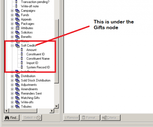

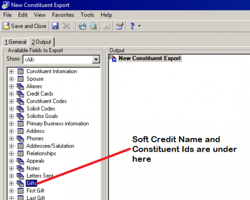

If you create a Constituent Export, you can get at the Soft Credit information under the Gifts node (Hard Credit names would be under the Constituent Information node), but it does not include Soft Credit Email Address or mailing address information. You'd have to add that with a second Export and VLOOKUP.

Aaron Rothberg:
