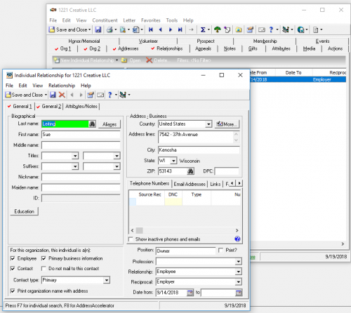

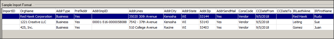

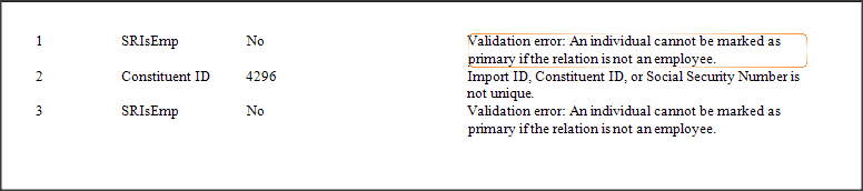

This is my first post and really hope someone can help me figure out my import validation errors. I set up my import to import a .csv file of new organizations and to update existing along with individual relationships for each (contacts at the org). I am working on a test of three rows of data. Two row will be new orgs and contacts and one row will be to add the contact to existing. I've had it work two separate times but when I run again I get new errors. The errors are always with a field of SR (SRRecip, SRRelat, SRisEmp). I have no fields of SR, only IR's. When I unchecked the box to make Relationship and Reciprocal required, it got me past the error, until I ran it again. My key indicator is O. Has anyone had errors like this or know what might cause them? I think my import is trying to create spouse information on the record, but I don't know where/why... I appreciate anyone's input. I'm just so frustrated right now. Here's a copy of my fields tab and my csv datafile. Thank you!!, Liz

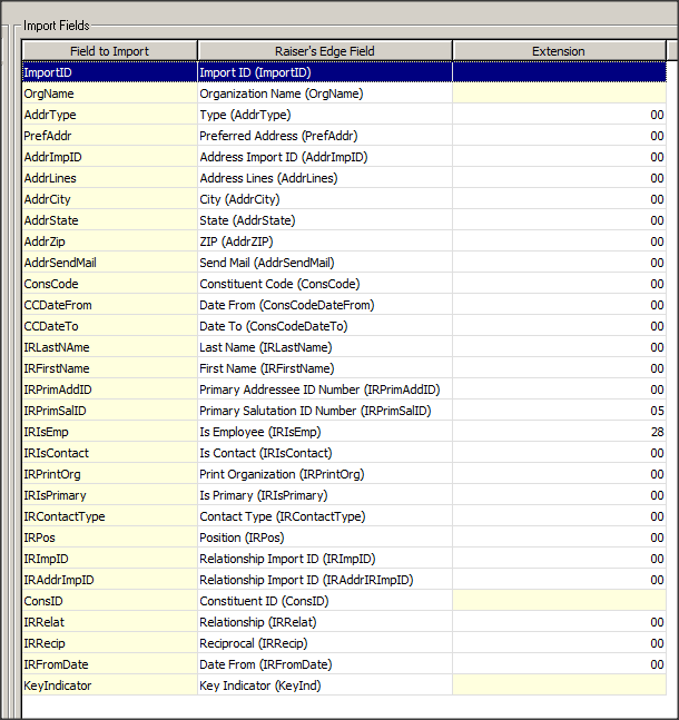

Thank you so much for the reply. Attached are my errors. The type of import is constituent. I don't know how to specify if it's constituent to constituent or constituent to organization. Can I specify that? Also, I choose constituent ID, for ID used, not sure if that makes any difference.

I don't see any SR fields in your import so to get the error you're seeing, I think one of the fields in your source file may be incorrectly mapped to an SR field. It's just a guess, but I'd double-check your mapping. Posting a screenshot of your pre-import Mapping will clear up whether or not this is part of the problem.
Another thing, looking at the error, Import is saying that you are only allowed to check the Primary Business Information checkbox when the relationship is of Rel Type Employee, but that's not true. I just imported a constituent with the Rel and Recip Rel Type of Member and it accepted all of the check boxes including Primary Business Information so something else is generating that false error.
EDIT: I think the error about checking the Primary Business Button is not the Rel Type Employee, but the Employee checkbox. Import is telling you that you cannot check the Primary Business Information button for a constituent where you did not also check the Employee checkbox and that is true. If you plan to check the Primary Business Information box, you also have to check the Employee box.
Can we see a screenshot of your mapping?

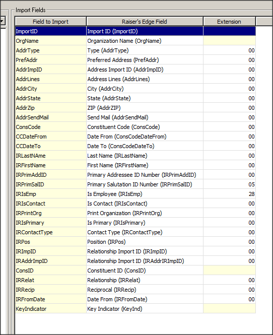

Attached is a copy of my mapping and fields. What is strange is that I actually got it to create two records and update one. But when I ran again, I got an error. I will change to import only new.0
Weird. Your mappings are fine. Without seeing a recorded video showing you go through the import, I am completely lost on why you'd get SR errors. Let us know how it goes when you keep constituent updates and new constituents in two different imports.
As for the error the second time around and one record not importing, if you're referring to the second exception in your exception file, it's because you are trying to import the same Constituent Id twice which Import is catching and excepting out as it should.0 -

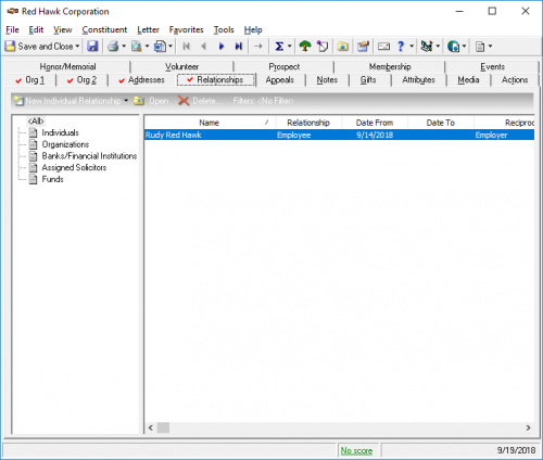

I took your advice and created a new import mapping to my existing datafile, and OMG it worked! Something must've been embedded in the original import. I can't believe all the time I've spent on this when it wasn't my error...THANK YOU so much for suggesting that. Has this happened to you before?1
Weird indeed!!! I took the suggestion of Cathleen Mai and created a new import and mapped to my original csv file and MAGICALLY it worked with no errors!
It added my contact to the existing org and created two new orgs with contacts. Something must've been imbedded in the import.

My import validation error has finally been resolved due to Alex Harker and Michael Hayes from Chat help. The data was NOT corrupted and re-writing the import didn't fix my problem as I thought. The reason I was receiving the SR errors was because I was trying to import new constituents -- some contact names (IR's) and some with no contact names. The import was looking for the non-existent contact names to apply the IR fields (such as reciprocal, relationship, etc.), and because they weren't any contact names, it returned an error (a better error would've been helpful). Once the fields for IR's were deleted of those with no contact names, it validated clean.
So, if you're importing orgs with some contact names and some without, be sure to clear the IR fields for those without a contact name.
