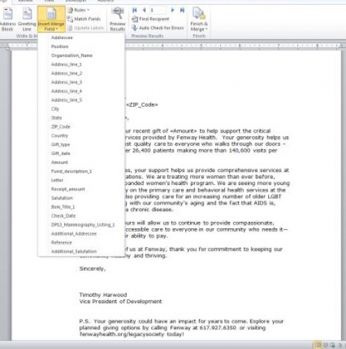

    Just to confirm when you say you manually added-in all the fields just in case the copy/pasting wasn't working do you mean within the mailing wizard you selected the field from the Insert Merged Field within the Word document while in RE - like photo below:
    348d601cfdbc12bc40f783d1f3073ccb-huge-wo
    And all merge fields have << >> around them like <<City>>, etc.
    And that after you went all the way through the Word merge wizard you hit finish and saved and closed the mail merge?

    So, I originally added those fields from the "Add-in" tab (is there a difference?) so I just now went in and added them from the "Insert Merge Field" tab and it's the same thing. My final result looks like this:
