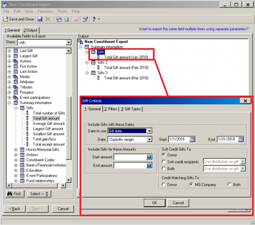

Depending on your definition of returning and recaptured you could create a constituent export with these fields:
- Last Gift
- gift date range of last month
- First Gift (include all dates)
- Last Gift
- gift date range with a To date = the last day of the month, two months ago (June if running for July gifts)
- New Donors =
- Last Gift (#1 above) is equal to First Gift
- Returning donors=
- Last Gift (#3 above) is between whatever date range depending on your definition of "returning." For example, if they are returning if they gave in the past year, then this Excel formula would be If the last gift (#3) is between 8/1/17 and 7/31/18.
- Recaptured=
- If Last Gift (#3) is less than 8/1/17 (assuming recaptured = over a year since they last gave)

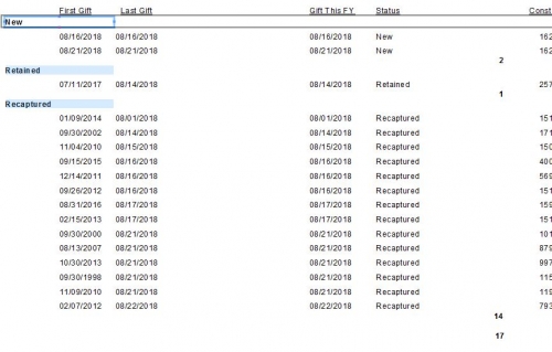

The donor giving analysis dashboard has all of these categories and it works if you put in a date range equal to a complete fiscal (or calendar) year. But the instant you put in a date range of a month - it changes the comparison to compare month over month instead of continuing to compare this month's gift to their giving in the previous fiscal years. No one does that. Why was the report designed this way?
This happens when at the end of the FY you do this awesome analysis and give them all this data based on the year. Then each month they want to now see how they are tracking. But you can't in this "awesomely" designed donor giving analysis. Even if you minimally could use a constituent query in the report and only have it show this month's donors - then the date range can remain the full FY. The problem is the date range you enter is twofold - picking the constituents it includes AND determining the dates to compare. That is just dumb.
EDITED - kept calling it the donor category report but I meant the donor giving analysis0 -

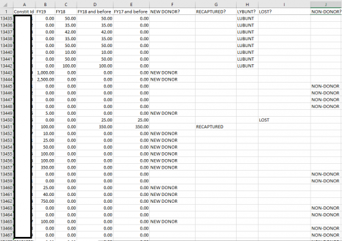

Another hour into this and I finally have something, but it's by no means simple.
Here are my columns:
Here are my formulas:
NEW DONOR: =IF(AND(D2=0,B2>0),"NEW DONOR","")
RECAPTURED: =IF((AND(E2>0,C2=0,B2>0)),"RECAPTURED","")
LYBUNT: =IF(AND(C2>0,B2=0),"LUBUNT","")
LOST: =IF((AND(E2>0,C2=0,B2=0)), "LOST","")
NON-DONOR (column J, says DONOR? above): =IF(AND(D2=0,B2=0),"NON-DONOR","")
The process would be to Export the query fields and paste these formulas into the correct columns and you get something like this:
PS. I will now take lots of aspirin and delete this grotesque monstrosity.
PPS. I can't spell LYBUNT0 -

PPS. I can't spell LYBUNTThat is amazing! Thank you so much for the time you spent on this! I can't wait to try it!
I've done something like this several times using Excel, and once using Access. Excel formulas can be a huge time saver. I suggest that you set up one tab for the results/formulas and one tab for the data. Then when you want to refresh the report every month, you can export the fresh data from RE, copy-and-paste it into the master Excel document's Data Tab, and the formulas should update to show the new set of results.
