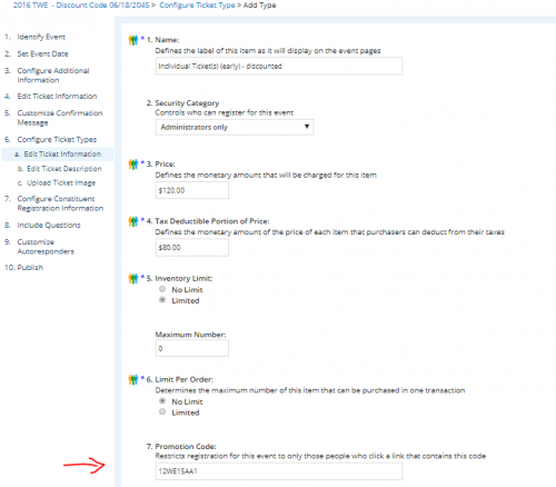

1. I created a discounted registration level and protected it with a promo code. (I just made it the same as what they'd given out as a discount code - 12WE15AA1 - it doesn't matter since no user will actually need to input the promoCode link themselves.)

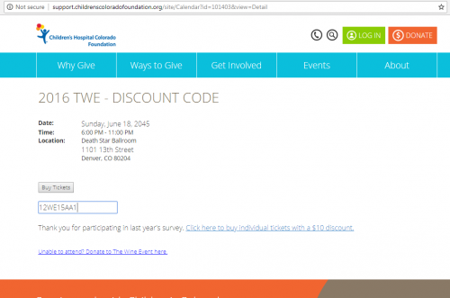

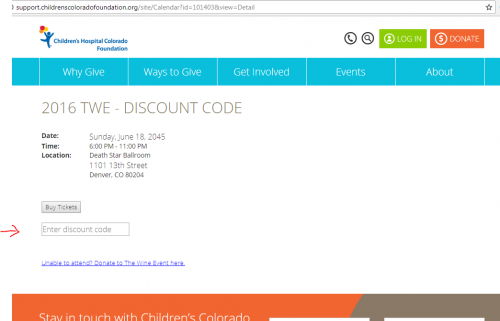

2. Next I added a little block of text to the first screen of the ticket form, which contained the link with the promoCode embedded ("Thank you for participating in last year's survey..." in the second image below.) I also added an input box for the "discount code" (see first pic below), and put on some jQuery to hide/show the promoCode link text, so that only people who entered the appropriate "discount code" in the box would see the text with the promoCode link.
Before user enters code:
After user enters code:

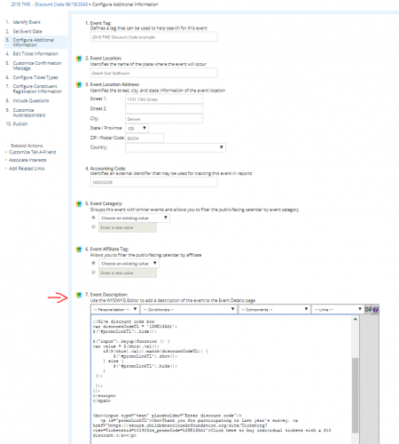

You can add this functionality in the event description html box:
Input box and discount code link html:
<br><input type="text" placeholder="Enter discount code"/>
<p id="promoLinkTL"><br>Thank you for participating in last year's survey. <a href="https://secure.childrenscoloradofoundation.org/site/Ticketing?view=Tickets&id=100601&s_promoCode=12WE15AA1">Click here to buy individual tickets with a $10 discount.</a></p>

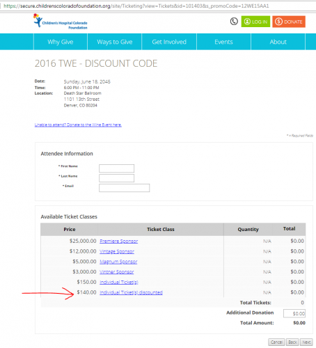

3. Then, clicking that link takes the user to the ticket selection page with the discounted level activated.
