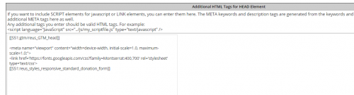

Hello,
So, I'm out of ideas. I've read every article I could find, and tried to install this code about 100 different ways...I don't know why it's not working. I have the code in a reusable page builder page, and I included it in the head section of all my page wrappers. For some page wrappers, the code install seems to be messing up the page wrapper itself, not showing logos, buttons aren't working etc. For some only parts of the code seem to be working (the part in the body, not the head).
Here is my pagebuilder code.

This is where I link to the reusable pagebuilder

3. Insert [[S51:gtm_wrpr_head]] in the "Additional HTML" section of Luminate Online pagewrappers.
4. Insert [[S51:gtm_wrpr_body]] at the very top of the section of Luminate Online pagewrappers.

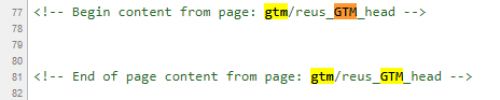

Sara Hoffman:
Looks like the content in "reus_GTM_head" isn't published.
You can check this by adding "&s_debug=true" to (any) LO URL and within the View Source code, it'll insert the <!-- start --> and <!-- end --> for every reusable used.

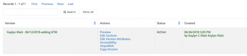

Hi Sara,
Looks like it is published though? Unless I'm too deep in this and just can't see something simple?
Thanks so much for your help!
It could be a WYSIWYG issue where the comment or <script> tags are stripped funny. Can't tell you much more without looking more in depth into the HTML of this pagebuilder page.0
Sara Hoffman:
It could be a WYSIWYG issue where the comment or <script> tags are stripped funny. Can't tell you much more without looking more in depth into the HTML of this pagebuilder page.I THINK I FIGURED IT OUT!! I removed a folder location from my s tag code and that seems to have worked! I can see it in my tag assistant checker now....THANK YOU
