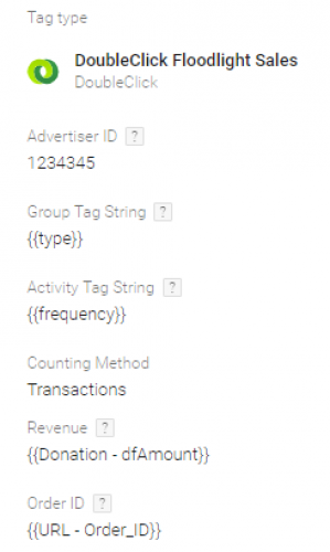

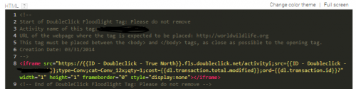

Also, it looks like you've got Google Tag Manager in play here as well, so on the Thank You page you can pass your S-tags to the dataLayer, use GTM Variables to read that data and then fire DoubleClick from GTM.
Here are two examples:
