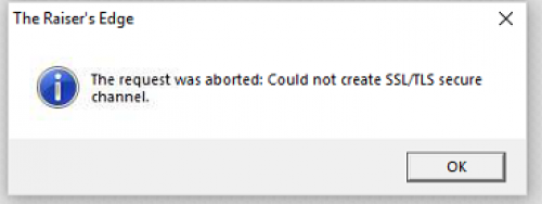

Hey there, i was able to fix this issue that is occuring on our workstations this AM. Basically, if you try and go into online express for the raisers edge, you get an invalid SSL/TLS certificate.
The request was aborted: Could not create SSL/TLS secure channel.
The fix is to download a file from RE called " HotFix_EnableStrongCrypto.exe ".
you can read more about it here:
https://kb.blackbaud.com/articles/Article/118644
The fix does work and i am now able to log on for my users.
click downloads on the left -> " The Raiser's Edge 7.96.6401, Patch 11 and Online Express HotFix Utility " -> then scroll down till you see HotFix_EnableStrongCrypto.zip
hope it helps.
