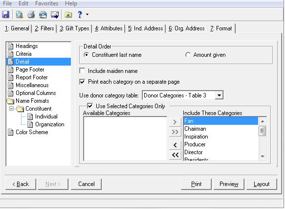

Cathleen, what settings do you use to get all gifts from a donor summarized for the time period vs. listed individually in the Donor Category Report?
First you have to set up your "Level"-table in Configuration/ Donor Categories.
Define the levels.
Then in the Donor Category report go to the last tab - Format
On the left go to Details.
Then choose your table. The report will summarize by the Levels in this table.
See attachment.
