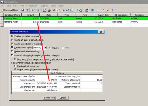

Aaron Rothberg:
She's entering the first gift in the first line of the batch, which will not be picked up when you commit. Check out the dollar total of my batch. It's excluding the first gift.
Thanks Aaron, but that's not the problem. The gift that doesn't commit is on the second line, the first line is the default line which is blank. EDIT: The batch stats are correct, but the 2nd gift that's listed as $100 doesn't commit to the donor's record. When we run a query on batch #... that $100 isn't there
