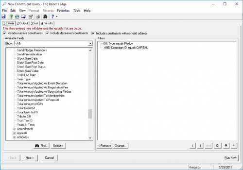

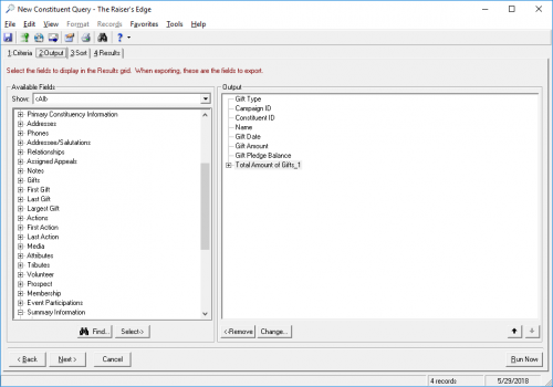

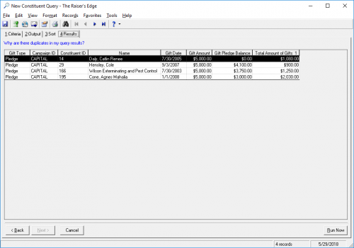

Although you can't specify in a query or report to give you the top 100, you can export all donors to your campaign and sort by the amount they've given and take the first 100. Depending upon your goal there are a number of ways to do this. If you want to take a peak at what this would look like, use a Constituent query, in your criteria constrain the Gift Type to Pledges and constrain your Campaign to the one of interest and then output Gift Amount, Pledge Balance, and include a summary of gifts given to the campaign.
Of course you'll be told by others that you should do this work in Export and it's true, but practicing with query will give you sense if you are headed in the right direction.
Here's an example:
I see Claudia recommended using a Gift query, but note that you can't do Gift Summaries in a Gift query. For summaries you need to use a Constituent query. If you did not need summaries for total giving to a Campaign, then I would use a Gift query as she suggested.

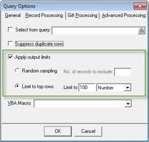

So my guess would be that BB is saying it can't be done because of the "top 100" part ...You can't limit output for dynamic queries but you can for static ones:
(I've never quite understood why you can't do this with dynamic queries, btw. It seems like a strange limitation. Does anyone know?)
