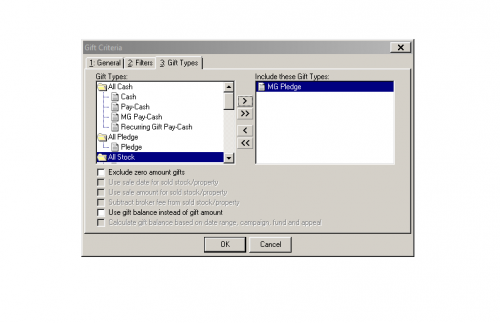

  • Hi,
    I admit, I don't work with matching gifts, but I don't understand why you wouldn't be able to see the original date of the pledge and then the mg pay-cash associated.
    When your in the export tool, under "gifts"' there is the matching gifts table.  If you exported the field for "Gift Date" entered the dates you want to see and choose the type of gift as the MG Pledge and then
    choose gift date field again, choose your dates and then MG Pay-Cash as the gift type, would this not give you what you want?

    Hi Brenda,
    I can do it that way but I was hoping to export out the pay-cash and see which pledge it is associate with, looking at it backwards.  Regardless I was able to explain the variance on the report and everyone was okay with it.
