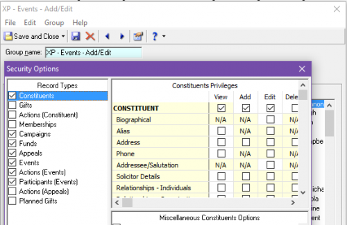

    Also, unrelated to the terminology or what you're trying to import, do check your security permissions. There's an interesting one where in order to add anything to Constituents' Event/Participant info, you have to be able to edit the constituent record itself (even if you're not given permission to specific things on the record). So if you don't have Constituent -> Add, Edit you can't import event stuff to them.
    97dd26b8ac69f022cf162388bb96fcd6-huge-ev
    This is a screencap of the constituent security permissions that allow my users to link a participant to a constituent.
    But if you're okay on this, we can look at your import settings to figure it out.

  • Okay, yeah, if you've got admin rights then that won't matter. (Just in case it helps someone else, though, I'll leave it!)
