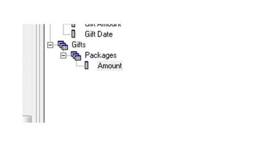

Hi Carlos-
In a constituent query, select Summary for Gift and when the Edit Field Criteria dialog pops-up, collapse the GIFT INFORMATION node, expand the PACKAGES node and select your Package Id. You can combine your Package Id with your desired Gift Types under GIFT INFORMATION or your desired Appeal under the APPEALS node.
In your export, right click on the Gift Amount, and select Column Heading. Then you can enter whatever you need for the heading, such as CMNCOHSA18.

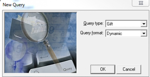

Yep, we typically just refer to that as a 'gift query.' You'll see folks referring to gift query, constituent query, action query, event query, etc., quite often here in the forums. Each of those adjectives relates to a query of one of the specific types availabile when creating a query.0
