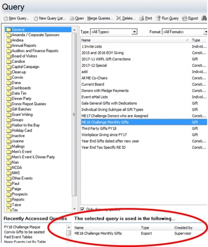

I do know when you are in the query screen and you click on a query down below there is a "The selected query is used in the following..." and it will list exports, reports, dashboards it is used in - I'm not sure if this is a user option setting though

There is an article in knowledgebase about this:
https://www.kb.blackbaud.com/articles/Article/607750 -
