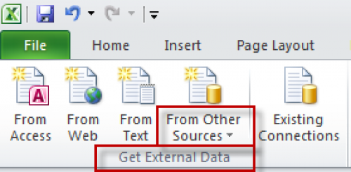

    I don't have "Get External Data" in my version of Excel, but I do have "From Other Sources". I go there and select "From SQL Server", enter the name of the Server using Windows Authentication, and then when I go to select the database my only options are "master, msdb, tempdb". The name of our production database does not show up. I'm guessing this is because it is hidden by RE. I tried using my RE login and that doesn't work. At this point it doesn't matter which user I use because I don't think the table is exposed.
    Ray
  • From Other Sources is an item in the Get External Data ribbon group:
    2c5f489ad0d155dd11d28d4c6946c68a-huge-08
    You still need to set up your SQL Server/Instance/Database access (Login/User) properly, I think.
