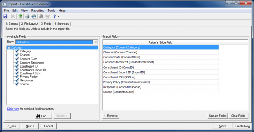

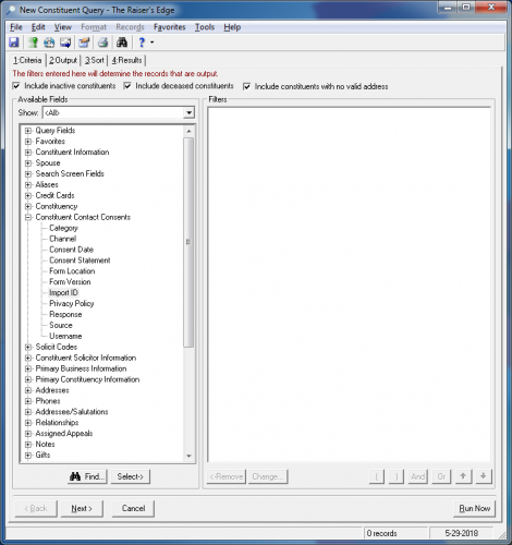

TomWe installed Patch 10 last week.
The mostly good news is that: You can Import and Query on Consent records.
(You might want to save these screenshot as documentation for now.)
Import:
Query:
The only downside is, as far as I can tell, you cannot export them-- at least when I searched a constituent export for "consent", I came up with nothing.

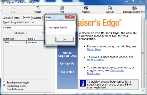

The same happened when I tried the help file:
I think the problem is that, traditionally, patches were minor updates not needing updates to documentation, and not needing much of a write-up in the patch readme.
But if I understand correctly, Blackbaud will, from now on, just be issuing patches, and no longer be issuing major updates. That's fine except they need to also actually let us know when the add features-- and, ideally, they should maintain relevant sections of the help file and RE7schema.chm as well.
Import:
Query:
But if I understand correctly, Blackbaud will, from now on, just be issuing patches, and no longer be issuing major updates. That's fine except they need to also actually let us know when the add features-- and, ideally, they should maintain relevant sections of the help file and RE7schema.chm as well.Hi
You may already know his as it's been a while, but you can export using Import - Create Import File.
Just tested it out as we only just ran the patch upgrade at the weekend.
