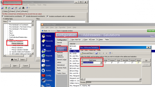

Yes, this can be done, but you'll have to hack the query a bit and it requires some initial setup in Config and you'll need to use Global Change. Here's how to do it.
Go into Configuration -> Addressees/Salutations and create a new Additional Addr/Sal that contains only the Constituent Id. Next, you'll have to use Global Change to add your Additional Addr/Sal to each constituent record. Finally, in your Relationship query, under Individuals, select Specific Addr/Sal and choose the one you created. Note that although I've placed a red square around Primary Addressee in my screenshot below, you'll expand Specific Addressee/Salutation to find your newly created Additional Addressee/Salutation that contains the Constituent Id.
I wouldn't recommend doing this. It's a lot of work to place an additional Addr/Sal on all of your records simply to complete this one task and for constitency you'll want to add this additional Addr/Sal to new records as you create them. Point being, if you absolutely have to have this functionality it can be done and this is one way. There may be others.
