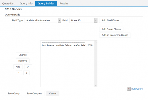

I run a query each month of people who already gave that month before sending out a second appeal. It used to work just fine.
Today there's suddenly a problem. We have over 320 donors, but when I try to pull them into a query that's supposed to get those whose last transaction date falls on or after Feb 1, I only get 42 results.

Can you provide a screenshot of your query? Maybe someone will see something that you're missing. Sometimes it just takes a second pair of eyes.
Good morning. I think there is an issue with this. I tried the same thing and it pulled in people who never donated and didn't pull in people who did. I would open a trouble ticket. Provide them examples of any that are incorrect or missing. Maybe they could shed light on the issue.
In the meantime, you could work around it by running a transaction report from Donation Management for the month.
Unfortunately, you can't add them to a group from here, but you could always download the file and then upload them as a group assignment upload (https://www.blackbaud.com/files/support/helpfiles/luminate-online/help/luminateonline.html#../Subsystems/DataManagement/Content/Concepts/Admin_ImportExport_GroupAssignmentUpload.html). We often do this because it's more reliable when wanting just to filter out those who gave to specific forms, but we forgot to create a group for them (or there are several).
Hopefully someone else in the community might see something else I didn't. Good luck!
Did you log a support case? We are having the same issue - the last transaction date on the constituent's profile tab is NOT actually showing the last transaction, but an older one - so that's why the query isn't getting everyone that you expect.
