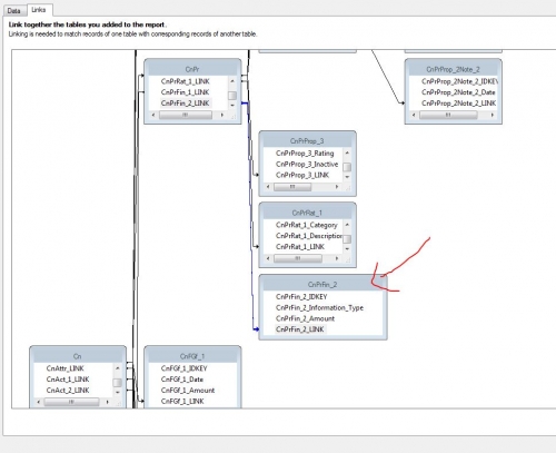

  • Not sure if this helps, but this is what I am linking.
    40017b84e8edfe0acc1447cbbed00c3a-huge-li

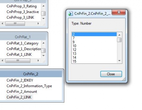

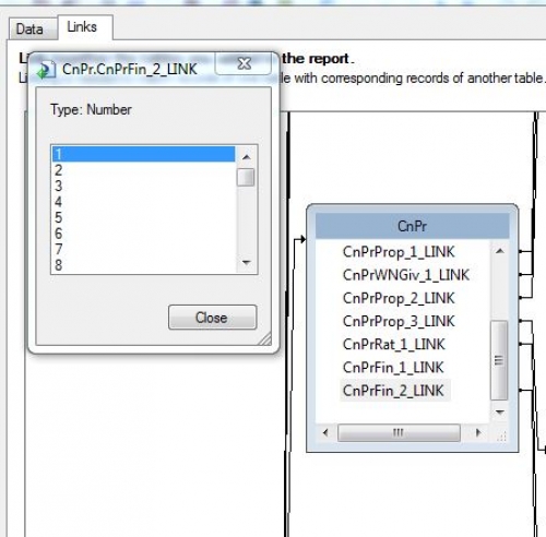

  • On the surface, that looks right.  But I'm wondering about CnPrFin_2_IDKEY.   On the field explorer, right click on CnPrFin_2LINK inside the CnPr table and Browse Data.  Then, do the same for the same in CnPrFin_2.  Are they the same data?  If so you probably have the correct join.   But also look at Browse Data for CnPrFin_2_IDKEY  inside CnPrFin_2 and see what that data looks like.  I've seen some databases (Not RE) where they have a particular field like that for the KEY for that table.  It could be that you link to there instead.  You could always try it and if it doesn't work, switch it back.
  • I think you are onto something! One link is correct, the other looks like it is skipping. That may be the issue!
