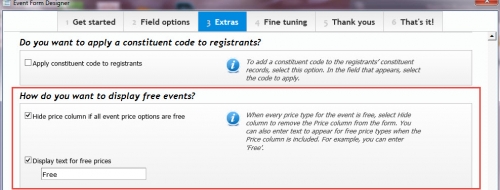

Hi Julia,
When you set up an event registration form in Online Express, on the Extras Tab, you can choose to hid the price column for free events:
If you have this option checked and all of your pricing options are free, you shouldn't see the Price or Total column appear. The Total column will still appear if you are also offering the option to make an additional donation on the form -- otherwise, you shouldn't see it!
I hope that helps!
