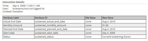

Yep, it's where I would start. You don't know what's causing the missing email address, right? In interactions you can see the history of the record.
So maybe they were created with one, and then later a DataSync occurred that overwrote that email address. Or perhaps only donors to a certain form have this problem. Or maybe it's just imported offline donors.
So for instance, here's a donation log that shows exactly which fields are affected.
A UserProfile edit shows the same thing, as does a DataSync and so on. So you are looking for an interaction that involves the primary_email address.
