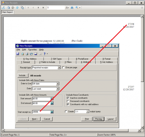

I don't use Mail, but I just finished running a couple of tests and that receipt number option is definitely buggy.

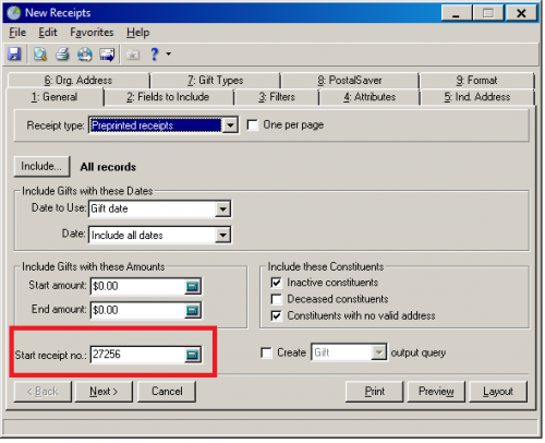

When I open receipts, you can see the receipt number it defaults to in my system, 27256.

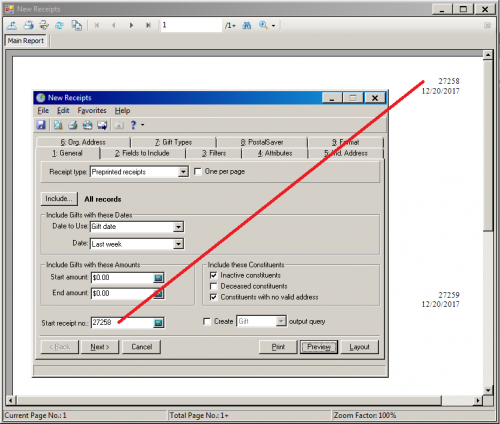

My first attemp to change the number to a different 5-digit number didn't work:

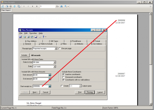

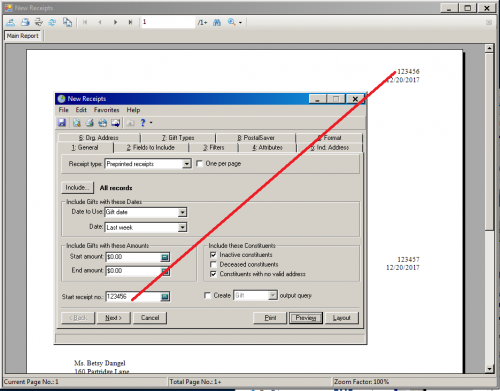

My next test was to change my 5-digit receipt number to a random 7-digit receipt number. That worked.

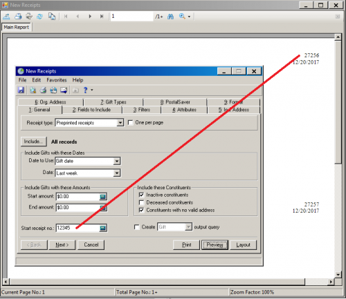

So I tried again going back to a 5-digit receipt number. It didn't work.

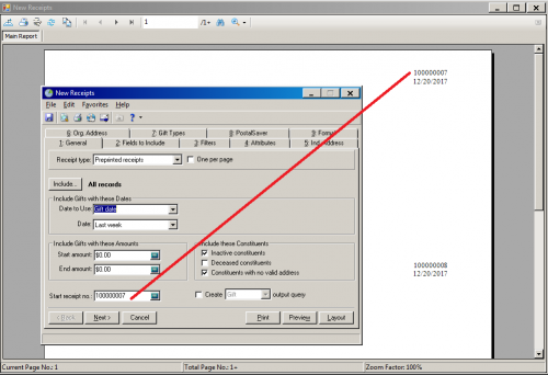

Then I tried a 9-digit receipt number. That worked.

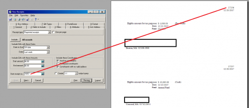

Then I tried a 6-digit number. That also worked.
Lastly, I tried another random 5-digit number. It didn't work again.
The Receipt Number feature in Mail is definitely not stable.0 -
I just tried 3 and 4-digit receipt numbers which also did not work, but if I chose a 5-digit number that's higher than my default number (27256), it works. This is the key piece of data I needed to discover what was happening.
What this tells me is that something in your database caused Mail to believe the next available receipt number was a 7-digit number. Setting that number to anything less than what the database thinks is the next available number causes receipt numbers to break.
So, the question for support is not, "why can I not user a lower number than what it defaults to" because by bug or by design, this is how Mail Receipts seems to work. The question to support is, "what made that default receipt number jump from 5-digits to 7-digits?" If you can't identify that, it may happen again. ¯\\_(ツ)_/¯1 -
One last observation. When I query our database for all gift receipt numbers, I find the highest number is 27255, one number below my default receipt number in Mail Receipts. I bet you dollars to doughnuts that if you query your database for all gift receipt numbers, you're going to find one gift that someone entered a 7-digit receipt number on and it's that one gift that caused your default receipt number to change. If you find that one gift and change the receipt number back to a 5-digit number that is still higher than all other receipt numbers, I bet you your Mail Receipts will start working again just as you would expect them to.1
