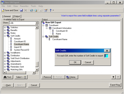

If you search the Community for Donor Advised Funds you're going to find a lot of comments, but the short answer is that if you want to see the hard credit to the DAF and a soft credit to more than one person on the same line, you'll want to use a Gift Export.
The screenshot below will output the name of the hard credit recipient and up to two soft credit recipients.
