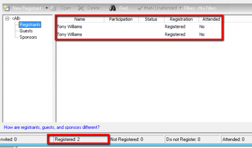

The Registered number on the bottom of the RE event record represents the total number of line item entries with the status of Registered listed under Participants > Registrants, Guests, and Sponsors. For instance, if Tony Williams appeared twice under Participants > Registrants, the Registered count will show as 2:

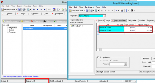

If Tony Williams is only listed once but has bought two registration units (two tickets), the Registered number at the bottom will only show 1 since there is only one person listed in the Regsitrants grid:
