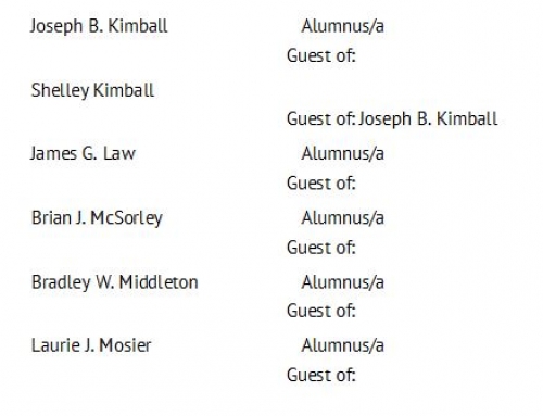

I made a report for our events. I did the report to add participants, guests, etc. My question is this: I want to put Guest of... if a participant is a guest of someone. I can't figure out the right formula or where to actuallyput the field so that it puts Guest of (name) when there is someone that is a guest, and then it does not print anything if they aren't a guest. Thoughts?

MichelePut the label and the field {Prt_Guest_Of} in the report, then right click the label and choose format field. Click the formula button next to suppress on the common tab. In that formula box put in
Isnull({Prt_Guest_Of}) or {Prt_Guest_Of} = ""
And hit OK. That will suppress your label saying Guest of: if there's no info in the guest of field. You don't need to do it for the guest of field itself.

Michele - You may have already figured this out, but the label he was describing would be a text field that says Guest of and that is the field that you would suppress if Isnull({Prt_Guest_Of}) or {Prt_Guest_Of} = "". I hope this helps.
