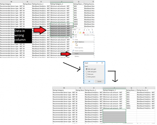

  • You're not missing anything, Tammie. Export only allows you to filter based on Rating Source, not Rating Category, and yes they come out in random order. For this type of task I'd export everything and then work in Excel. The random output will make it complicated, but if you sort, you can insert columns to try and line things up. I've successfully done this before with 30,000+ records, but it is time consuming.
