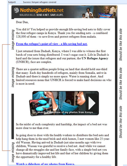

Suddenly on outlook 2007, the sides of my emails are disappearing. G-mail is displaying the email fine.
Check out this link to see the problem. I have mocked up the problem. The left side of the email shows the image broken vs. the right side which is what it's supposed to look like. But when I get the email in outlook, both sides look broken.

Thanks for the reply. Yes, I am using tables and the sides uses an image (not the exact hieght of the wrapper), and those side cells are filled by the background image.
Yes, the word redering should be the issue here. Maybe there's a CSS fix here.

I'm pretty sure Outlook 2007 doesn't support background images.
Colin McClure:

Another really good one is Campaign Monitor. And I've confirmed that Outlook 07 doesn't support background images.
Is there a solution here because I'm having the same problem and need a fix. Please help!
Per the code, our email cell spacing = 0
cell padding = 0
width = 560
Everything is align = center
Do these numbers need to change to allow the side banner to show up on the side of Outlook email and not in the bottom?
Do you have a link to the e-mail or a screenshot of it?0
