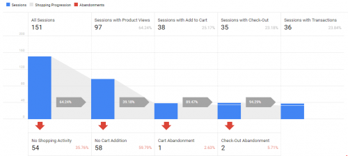

Option 4: Enhanced EcommerceThis one takes a little more planning and thought. Enhanced Ecommerce has a feature for "Product Views" which can be configured when a donation form page is viewed. Then the Shopping Behavior reports can create a funnel/path of users who have this behavior. I presented about this at bbcon 2016 - the slides are up on slideshare.
