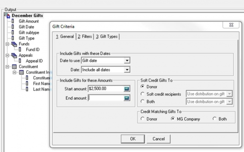

Are you right clicking from the Output tab, on the name of your export and selecting criteria - which then brings up the pop up box shown below (I right clicked ont the words December Gifts to get the box to come up - that is what I meant by name of your export)
Click on Filters tab to select the appeals you are interested in
To select the Criteria for the Gift, I clicked on Gift in the Output of the Export, and then on Criteria at the bottom. Filters > Appeals > Selected Appeals, and chose the Appeals used in the last three years.

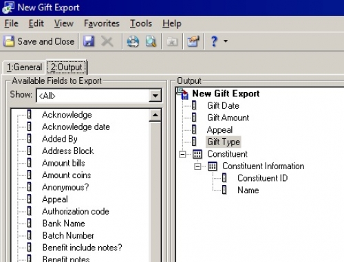

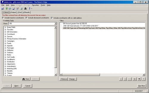

Hi Ashley-
I doubt my comment is going to be helpful beyond assuring you that what you are trying to do is possible in RE and I just did it. I created a Gift Query with three criteria:
Gift Date is between 7/1/14 and 6/30/17
Gift Type is one of (I included everything except the two Write Off types and the three Pledge Types: Pledge, MG Pledge, Recurring Gift)
Gift Amount is greater than 2500
I saved that Gift query then created a new Gift Export. In the Export I didn't do anything funky with gift parameters in summary fields or anything else complicated, I simply added the following fields to my Export Output:
Constituent Id
Constituent Name
Gift Date
Gift Amount
Gift Type (just to be sure I wasn't getting pledges)
Appeal (from under the GIFT node, not the stand-alone APPEAL node)
I have a 100% accurate list from Export, my appeal names correctly line up with each gift, and I don't have any pledges or write offs in there.
If you find time to post screenshots like Ryan suggested, I'm sure we can figure this out together.
