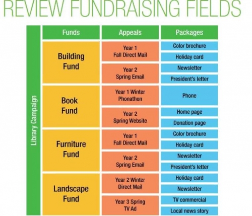

Looking at your structure, I would question why you are using "Mailings" as a campaign. Traditionally, Campaigns has been used to indicate the fundraising umbrella that your funds are all falling under. We have mirrored ours after our accounting setup - Annual Fund, Capital Campaign & Special Events. Those are our three largest fundraising "buckets" that we would want to be able to easily report on both internally and to our board of trustees.
Here's what our structure looks like:
Campaign category: Annual Fund, Capital Campaign, or Special Events
Campaign: Annual Fund FY2016, Annual Fund FY2017, Capital Campaign FY2016, Capital Campaign FY2017, Special Events FY2016, Special Events FY2017, etc.
Funds: Specific funds that line up with our GL funds. (Annual Fund, Infant and Women's Pavillion, Book Nook, Mary Awards 2017, etc
Appeal: The way we asked for the gift: Spring Newsletter 2017, LYBUNT Spring 2017, etc
Package: If we have segmented our appeal in any way then we would use this field to indicate that. For example, on our event mailings we will send something different to our past sponsors than we send to regular invitees.
Here is a great image that BB uses in their training that might help.
One thing that always helps me is to think about how you are going to report on the information that you are using. By doing that, you can back into how to properly set up your database.
Hope that helps!
