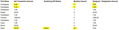

At this point, like I said above, the donation is going though, the API logs tell me that level_autoresponder=on was passed, and when I look at Sustained Gifts, I see nothing. I have a report built that shows me the designated gifts and it has some sustaining gift fields added as well, so I run that report and I saw something I didn't expect.
Two things are happening that I don't understand:
First, the tests I did (Christopher), show a number in the Monthly Amount, but doesn't show my Sustaining Gift Status as anything. You can see further down where someone used our older Sustaining Gift method and it's still active.
Second, even though my last gift shows $2, the Monthly Amount still shows 1, where you can see Alicia shows the $25 she gave. I ran into this before where people using the "Other Amount" option were getting autoresponder emails that showed they only gave $1, but further down that same email it shows the amount they actually gave.

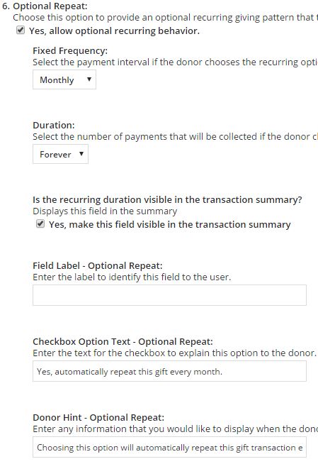

Thanks for the reponse. The Designated Giving Donation Level does have it's own built in recurring behavior, at least from what I can tell (see attached file). I did go ahead and try as you suggested though, and the gift came through with the "One time" status under "Payment Plan".
