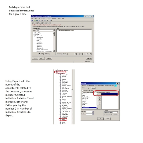

With the information you've provided I'm wondering if in Export you specified to include All Individual Relations or Selected Individual Relations? If you build a constituent query looking for the deceased members using the deceased date, you should be able to bring that query into Export and then from under Relations, select the objects you want about the other side of the relationship (Name) and only bring in the folks that have the relationship type you want. If I were to assume the Observer is the deceased and the mother/father is the living person, you could build something like this:
