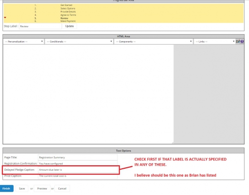

Nevermind, I found that label now -- it should be on the setting (see attached) as Brian has pointed out TeamRaiser > Edit > 12. Customize Page > Registration Summary
but just in case (if this is still needed) -- alternatively you could modify that through Javascript/jQuery, you should likely be able to change that "Maximum Future Payment" into something else you wishes through this snippet / similar fashion like this
