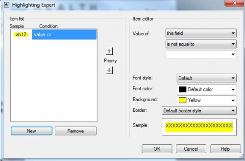

Somehow an existing crystal report - that I did not create but inherited - lost some formatting and I cannot figure out how to get it back.
Here is a screen shot of another field that is working properly
How do you select the condition of value <> - when I click New I just get a list of fields (but not all fields)

Right click on the field on the report that you want to apply highlighting to, then select Highlighting Expert.
Click the New button.
On the right side, Value of - this field, then below that in the pull down menu select "is not equal to" which is the same as "<>"
It isn't giving me 'This field" as an option - it just lists a bunch of fields from the attached data file
I was able to get it to work - I selected @<TemplateField1>
