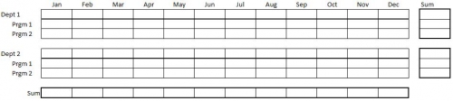

I'm working with our volunteer team to build a hours by program/department report... I've sketched it all out and I have the export all set and I'm not able to get the data to display the way I want. Here's my sketch:
All of this information is stored on the volunteer timesheet: I've got date, department, program (we co-opted the location field), and hours. I've also included import key, sort key, and name in the export. I tried to group by department with a sub group of location/program, then I supressed the details section so you can just see sum fields for the dept group and the program/location group. Then I tried to use select expert to filter to each time month... but that updated all of the fields so I'm pretty sure I'm doing something wrong.
Any tips?
Any tips?
